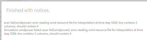

10 May 2023 12:30 #12141
Replied by Paul Gilman on topic Error running wind data file
Hi Daniel,
This error is caused by a missing temperature value in Line 5287 of the file you sent me by email.
I used a text editor to delete the trailing comma(s) at the end of each data rows, and then tried running a Wind simulation in SAM and got a more helpful error message "error reading wind resource file for interpolation at time step 5284: line contains 3 columns, should contain 4." (Because of the two header rows, Time Step 5284 is equivalent to Line 5287, where time steps start at zero and lines start at one.)
