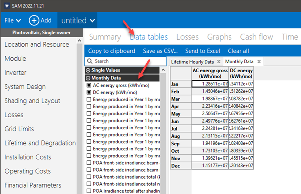

Can anyone please tell how to estimate the energy yield for each particular month ?
In the summary, I can see only for the whole year.

Hi Sahil,
You can see monthly totals of energy generation and other metrics on the Data Tables tab under the "Monthly Data" heading:

Just one more question: Can we also get the graphic plots for this data ?
21 Mar 2023 09:38 #12013 by Paul Gilman
Replied by Paul Gilman on topic Energy Yield
Hi Sahil,
The Summary tab of the Results page for some performance models shows a graph of monthly output values. Otherwise, you can use the Graphs tab to create a graph. You can always export the data from SAM and use external software to create graphs.
