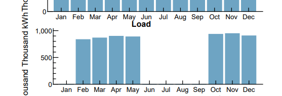

Hello, I am pretty new to SAM PVWatts and am constantly getting an error in the SAM report load chart
Is there a solution to fix the chart error in SAM PVWatts LOAD report when Load data for months exceeding 1,000 kWh is not being displayed? My electric load profile is attached

Hi Fatin Ishraq,
This is an issue with the PDF report generator which we will fix. Thank you for letting us know about it.
In the meantime, the best way to work with SAM's results is using the tables and graphs on the Results page. You can export images of graphs or graph data by right-clicking graphs, see the "Export Data and Graphs" topic in SAM's Help system: samrepo.nrelcloud.org/help/export_data.htm
