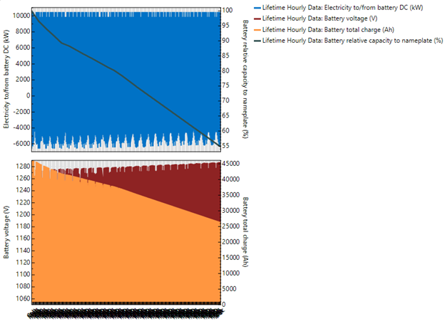

You can plot the battery total charge (Ah) and battery voltage (V) to see how those values change as the battery capacity degrades over time. This plot from your file shows the battery power, voltage, current and relative capacity to nameplate over the 25-year life of the project.
For a description of SAM's battery degradation models, see the listings under "Battery Life" on the Battery Publications page:
sam.nrel.gov/battery-storage/battery-publications.html

In SAM's battery model, battery power is not very sensitive to changes in internal resistance.
The cell internal resistance is an input on the Battery Cell and System page under "Battery Voltage," so you could experiment with changing its value there.
