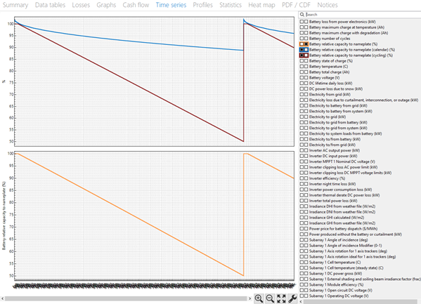

The annual profile graph on the Profiles tab of the Results page is not very useful for showing change over the life of the project. The profile shows the average annual change over a day. It is useful for looking at the generation profile of the system.
To see the effect of battery degradation over the project life, plot the battery capacity variables on the Time Series tab, and zoom out all the way to see the entire lifetime. This example shows the effect of battery replacement on its capacity, and you can see that battery cycling dominates calendar degradation:
