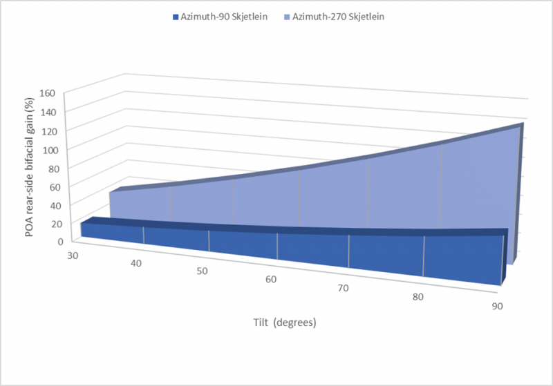

Different POA bifaciality gain % for Norway and USA
- Ronald
21 Apr 2022 08:51 - 21 Apr 2022 11:35 #10851
by Ronald
Different POA bifaciality gain % for Norway and USA was created by Ronald

21 Apr 2022 13:26 #10861
by Ronald
Replied by Ronald on topic Different POA bifaciality gain % for Norway and USA
Thanks for the quick reply. However, why there is a large gain between east and west for Skjetelien, Norway and there is no gain for Phoeniz, USA: I know that there will some gain difference for Norway but this is very large right?

27 Apr 2022 16:51 - 29 Apr 2022 18:10 #10900
Replied by Paul Gilman on topic Different POA bifaciality gain % for Norway and USA
Hi Ronald,
I think these results have to do with the data in your weather file.
Here are results from a parametric simulation I ran using the "S49 BiFa" case in your file with a weather file for a location in Alaska with a similar latitude to your weather file. It shows a similar bifacial gain vs tilt angle for azimuth = 90 and azimuth = 270:
The results with your EPW file confirm your observation below:
When I compare the DNI data for your file with the Alaska file, I see that the DNI data shows a tendency to be higher in the morning hours. I think that is consistent with the results showing that the irradiance on the back side of a west-facing array would increase more with the array tilt angle than for an east-facing array:
The Alaska data does not have that pattern:
Attachment bifacial-gain-vs-tilt-az-high-latitude-tmy2.png not found
Attachment bifacial-gain-vs-tilt-az-high-latitude-epw.png not found
Attachment dni-daily-average-profiles-epw.png not found
Attachment dni-daily-average-profiles-tmy2.png not found
