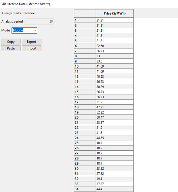

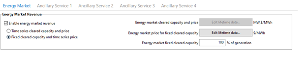

I'm discovering and testing the SAM Battery Merchant module. I've tried to test a simple case for a stand-alone project with only revenue from Energy Market (hourly price data). Despite entering usual/default inputs (see images below), the results don't give any revenue. It seems like the battery never charge or discharge.
Thus, could you please let me know if something seems wrong in my inputs or what could be the issue?
Thank you!

28 Mar 2022 15:03 #10740
Replied by Paul Gilman on topic Battery Merchant - Energy Revenue Calculation
Hi Nicolas,
From what I can tell from your screenshots, you are using a constant power price with a constant cleared capacity requirement, and have the battery dispatch option set to "automated dispatch."
You should see the battery discharge for the first few hours of the year and then stay discharged. The automated dispatch option is designed to dispatch the battery to maximize revenue from power sales at prices that vary from time step to time step. In your case, the price is constant, so it simply discharges the battery to maximize sales, and does not charge it to avoid the cost of charging the battery.
