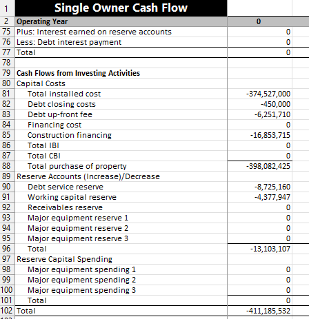

You can see how the Net Capital Cost is calculated by going to the Cash Flow tab of the Results page and clicking Send to Excel with Equations (Windows only). SAM opens a special Excel file that shows how the financial model calculations work:
