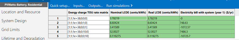

thanks for the quick response, I reckon that the simulation you have used is PVWatts, Commercial, however I am interested in PV-Battery-Residential.
I have run the simulation for PVWatts-Battery, Residential and here is the result:
The LCOE for zero electricity rates is 3.78219, when the buying price becomes 1$ the LCOE becomes 8.60424, the difference is 4.82205.
Now for buying price of 10$ the LCOE becomes 3.78219 + 4.82205 * 10$ = 52.0027 exactly as in SAM.
The same happens for the selling price, there is a linear dependency.
Now here is for my original question for PV-Battery, Residential:

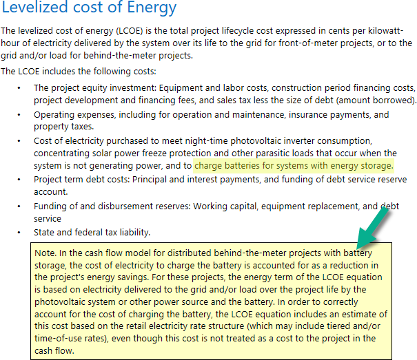

For behind-the-meter systems with batteries, SAM accounts for the cost of charging the battery in the LCOE calculation. This is explained in the description of LCOE in Help:
This approach ensures that comparing the LCOE for projects with and without storage is meaningful.
The note later in the topic that says "For distributed behind-the-meter projects, the retail electricity prices from the Electricity Rates page do not affect the LCOE." is misleading. That is only true for projects with no storage. I will revise that for the next update to SAM.
You can see the calculation in the C++ source code here. The CF_parasitic_cost variable represents the cost of charging the battery:
github.com/NREL/ssc/blob/ca964fc280268b4e4efe686dc66c3c01ad555430/ssc/cmod_cashloan.cpp#L1141
