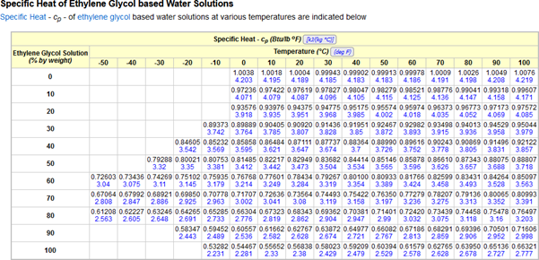

The working fluid option sets the value of the working fluid specific heat, which you can see in the code here: github.com/NREL/ssc/blob/d349a139d22e15396a6c99dbd7f9153f2d9b3a66/ssc/cmod_swh.cpp#L239 .
Based on this table from engineeringtoolbox.com, if we assume that the Cp values of water and glycol are at 40 degrees Celsius, the value of 3400 J/Kg-K seems to be a mixture of about 50%: www.engineeringtoolbox.com/ethylene-glycol-d_146.html
