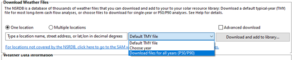

I want to use all the files from 1998 to 2020 in my simulation, but I guess SAM only uses the selected one.
The files are download all in a separated folder, I thought SAM was using all, but when I click to see the data only shows one year at time.
Am I loosing something?
I'm asking because when I choose automatic download SAM downloads a file with many "random" years, some years are like 2020 or 2019 are not in the file...
1 - Image from the separated folder
2 - Image from the files
3 - Image from SAM
3 - Image from SAM

Hi Leandro,
SAM's performance models use a single weather file that contains one year of data. It is not possible to run a simulation over multiple years using a sequence of weather files.
Weather files may contain "typical meteorological year" (TMY) data or single-year data. TMY data represents the typical solar resource over a multi-year historical period so that a single file contains data from different years. You can read more about TMY here: nsrdb.nrel.gov/about/tmy.html .
When you use the Download all years for P50/P90 analysis option to download weather files from the NREL National Solar Radiation Database (NSRDB), SAM downloads a file for each year in the collection (1998 to 2020 as of now) and puts them in a separate folder to make it easier to run P50/P90 simulations. See the "P50/P90 Analysis" video here for a demonstration: sam.nrel.gov/weather-data/weather-data-videos.html . For a paper describing how P50/P90 simulations work, see the publication listed under "P50/P90 Analysis in SAM" here: sam.nrel.gov/weather-data/weather-data-publications.html .
