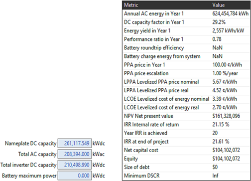

I am encountering the exact same problem as mentioned above. The annual AC energy 624'455 MWh
The nameplate DC is 261 MWp
This should give a Specific yield of 2392.5 kWh/kWp, but the summary gives 2557 kWh/kWp, which doesn't make sense to me.
Do you know where this comes from?

Hi Magnus,
Could you attach the .sam file that generates those results? In my tests, the "energy yield" metric is correctly calculated.
