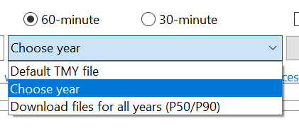

I used a weather file from the NREL National Solar Radiation Database (NSRDB) that I downloaded from SAM's Location and Resource page using the latitude and longitude from your file. You can use the Choose Year option to download a weather file for a specific year:
