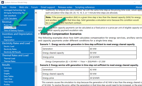

Hi Javier,
Yes, that is correct.
There is a section in the Help topic for the Merchant Plant model Revenue page that shows example compensation scenarios that might help explain how the cleared capacity works. You need to expand that section to see the scenarios and explanations:
