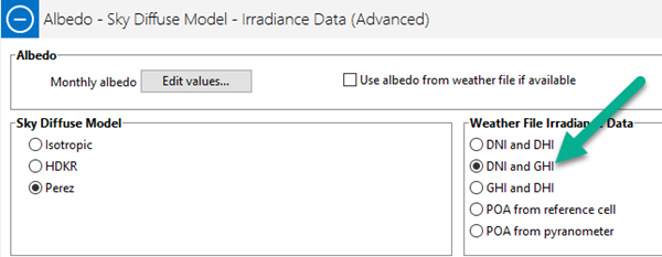

Because the file contains GHI and DNI data, it will not work with PVWatts, which requires DNI and DHI data. You could use the data with the Detailed Photovoltaic models if you change the Weather File Irradiance Data option on the Location and Resource page:
The file you sent has several semicolons at the end of each line that may cause problems for the weather file reader. Please use a text editor or other software to remove the semicolons.
