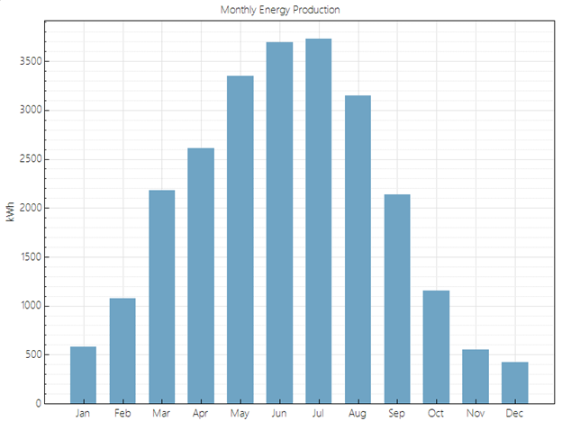

After SAM set accordingly to the standards of a fixed tilt/azimuth system, using a 0° Azimuth and the tilt=local latitude (15°), ie, modules facing north with the local latitude as the tilt, it MUST result in higher energy yield annually than in a 180° Azimuth setting.
And this is not what´s happening. For some reason, it seems that the calculations are being made as if the solar PV is located in the north hemisphere and has a higher generation facing south (180°).
Something is really wrong,
Even the Monthly energy production graph is showing an opposite result as the expected one. For our region (south of equator), it should have a lower energy yield in the months between May and August (winter solstice), and it´s not what´s happening, as you can check below, with its correspondent system design print:
I´ll have to endorse Luiz's report.
