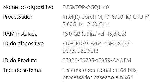

regarding the second point, that the simulation for the PTSA_RECIFE_CO using the corrected weather file for Recife was slow, but you completed it, my configuration is: (is it enough?)

Your computer has enough resources to run SAM.
