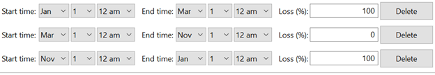

As I mentioned in previous Q/A, I simulate a project at Fort McMurray location where from November to February the solar irradiance is not strong enough to run the solar plant. Therefore, I would like specify this no operation period in SAM. One way as you suggest to specify system availability loss = 25% to account for the no operation period. However, this will derate the design production and capacity factor significantly as SAM consider the loss over the yearly basis. I tried to specify the specific no operation period using custom period function like this:

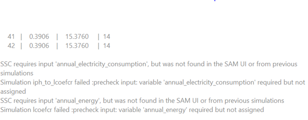

However, SAM generate errors when I try to run it with this customized availability loss periods. See below:
Please help to guide what else input I need to make it run. Besides, during the non-operation period, the plant will be moth-balled. So the heat loss and utility consumption should be considered separately - Let SAM simulate the operation on 8 month period for normal operation economics. Is there a way to do this?

I think the correct way to specify availability losses to cover the period from November 1 to February 28 would look like this:
However, I'm not sure the availability loss is being applied to the heat output of the process heat models.
Another approach might be to edit the weather file to set the DNI to zero for the period that the system is mothballed.
