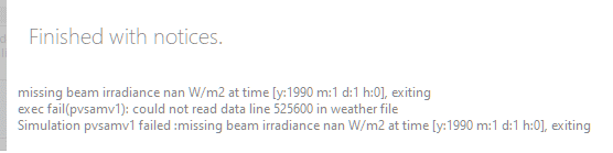

I have 1minute weather file with columns Year,Month,Day,Hour,Minute,GHI,DHI,DNI,TDRY,WSPD,WDIR and I can run PV system simulation succesfully. But when DNI column is not present in the file, my simulation does not want to run and results in error:
According to www.nrel.gov/docs/fy18osti/67399.pdf (page 12), SAM should be able to work with GHI+DHI data, without DNI.
Am I doing something wrong?
Thank you

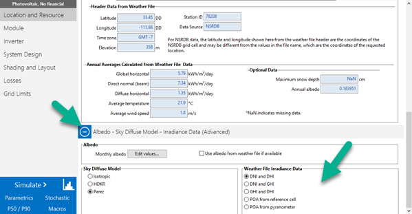

05 Oct 2020 09:51 #8807
Replied by Paul Gilman on topic Simulation fails without DNI data
- Branislav
05 Oct 2020 12:48 #8811
by Branislav
Replied by Branislav on topic Simulation fails without DNI data
yes, that was the case. Now simulation is running, and only several warnings appears:
