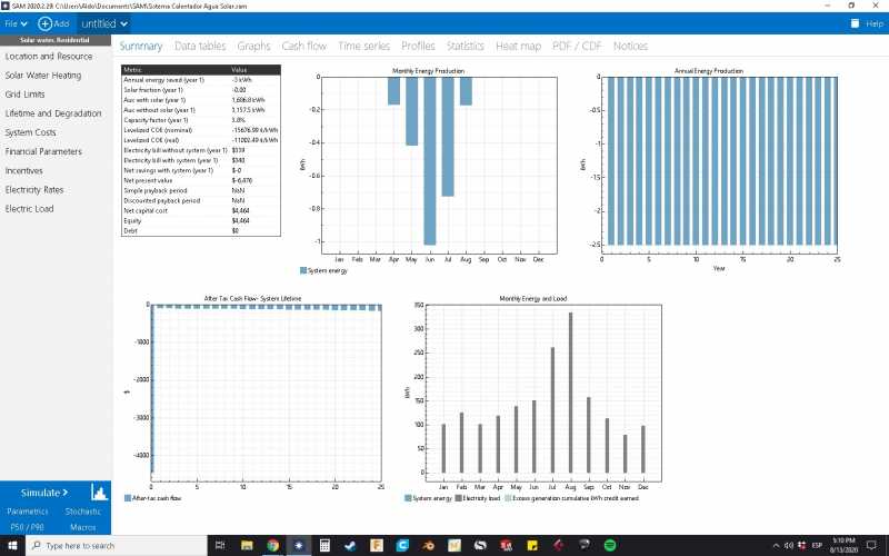

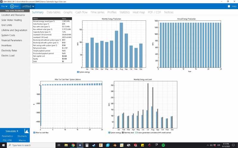

Hi, I'm having some issues about the results I'm obtaining from the simulation based on my inputs. Could you please help me with this problem?
I send photos of the simulation and the complete file.
Best regards.
Best regards.

Anyway, I think the error you are seeing is about the building electric load profile estimator (BELPE), which is enabled by choosing the Calculate Load Data option on the Electric Load data. You might try using the Input Time Series Load Data instead. This data is used for the electricity bill calculation, so may not be relevant to your solar water heating model.
I noticed that you are modeling a system in the southern hemisphere with a solar collector azimuth angle (on the Solar Water Heating page) of 180 degrees. That would be facing north, perhaps you should change that to zero degrees.
