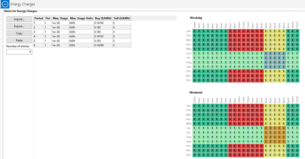

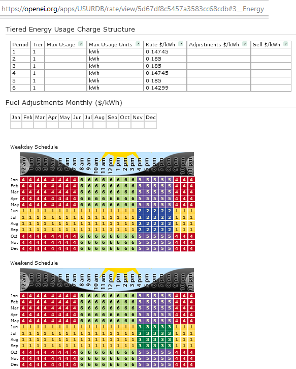

If there is a rate online that you would like to use in SAM, you could enter it manually -- the structure of the online database is similar to SAM's so it should be straightforward, if a bit tedious to enter the data. For example, the energy rate data for the SCE TOU-D-4-9PM residential rate looks like this on the website:
And you would enter it like this in SAM:
Once you have entered the rate data in SAM, you can use the Save rate data and Load rate data buttons near the top of the Electricity Rates page to use the data to use in different SAM files without having to enter it each time.

Thank you. I have the rates edited, but I can't figure out how to edit the schedule to specify when each rate applies.
06 Aug 2020 16:00 #8527
Replied by Paul Gilman on topic Can't Download Utility Rates
Hi Joseph,
That process is described in Help: Use your mouse to select a rectangle in the weekday or weekend schedule matrix and type a number to assign a period number to that section of the matrix. Use the letters a, b, or c if you need to assign numbers 10, 11 or 12 respectively.
