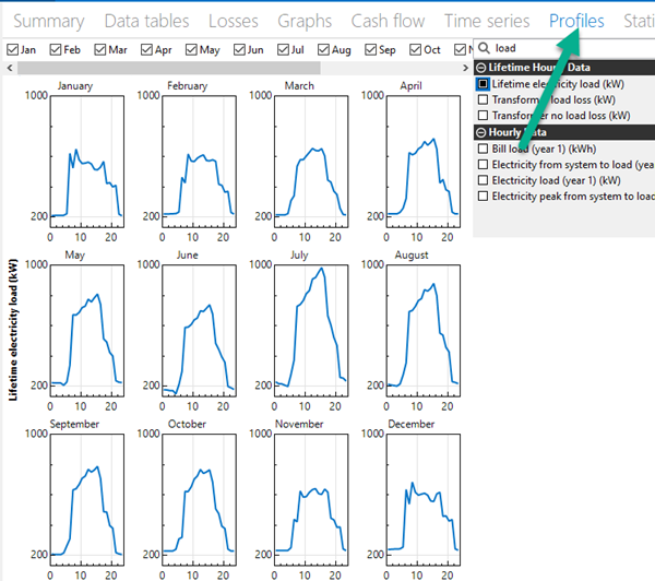

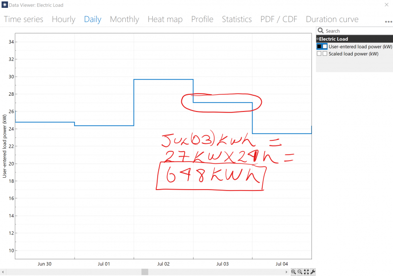

I think the "profile" tab show the average of, for example, every month's day electricity load kW or kWh in each hour, but to find the total kWh in one specific day we can use the "daily" tab in the load profile data and multiply the kW by 24 hours. See picture attached.
Let me know if I wrong.

Replied by Paul Gilman on topic Daily kWh from the load profile
Hi Carlos,
Yes, the Daily tab is available when you open the data viewer from the Location and Resource page, but not on the Results page.
