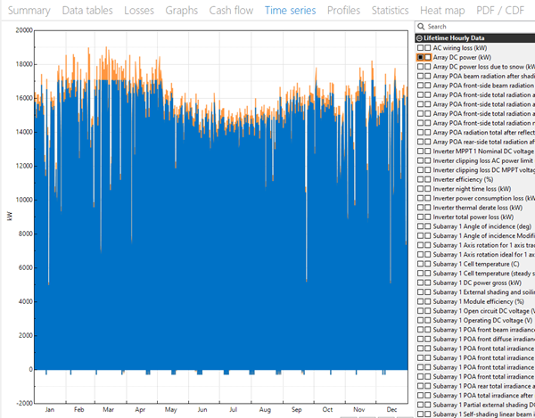

SAM's photovoltaic models run simulations over the life of the project, so the time series (hourly or subhourly) results are shown over the multi year period. One way to export data for the first year is from the Time Series tab of the Results page by displaying the first year of data, and then right-clicking the graph to export it.
For example, this graph shows the "Array DC power" and "System power generated" variables for January through December of Year 1:

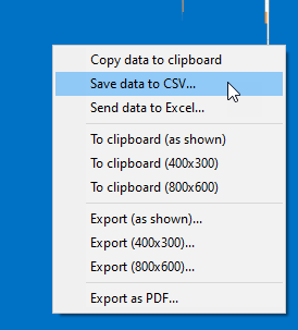

By right-clicking the graph, you can export those two variables for the first year to a CSV file:
