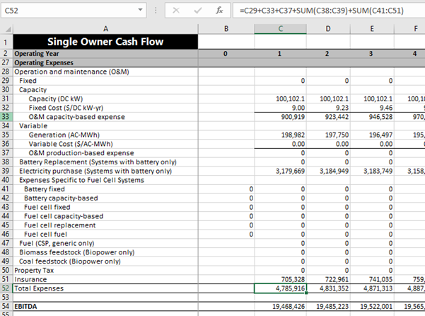

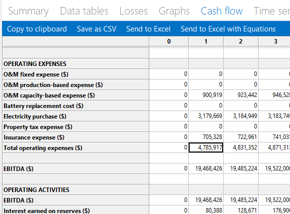

On the Cash Flow tab, the total of $4.79 million is equal to $900,919 + $3,179,669 + $705,328:
And the results are similar in the Excel workbook generated when I click Send to Excel with Equations:
Are you seeing something different?
I don't see the discrepancy you are describing in the file you attached. (I'm using the latest version of SAM, SAM 2020.2.29 r2).

Thanks, Paul.
I think I used the older version (2020.2.29 without the revision), thus missing the electricity purchase row. The revised version makes sense.
