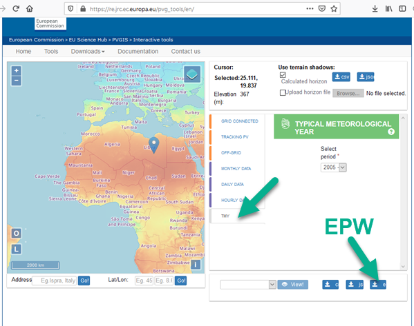

This appears to be a time series file from PVGIS V5. This file contains global horizontal irradiance (GHI), ambient dry-bulb temperature, and wind speed. SAM's photovoltaic model requires data for two components of solar radiation (direct normal irradiance, diffuse horizontal irradiance), so the data is not suitable to use with SAM.
The PVGIS website does provide access to solar resource data in the EPW format that can be used directly in SAM without conversion. You can download these from the "TMY" tab on the PVGIS download page by clicking the "EPW" button. (SAM's Solar Resource File Converter macro will convert files you download by clicking the "CSV" button to the SAM CSV format.)
However, these files do contain typical meteorological year (TMY) data rather than data for a particular year. TMY files combine data from months in different years to construct a "typical" file that represents the solar resource over a historical period.
