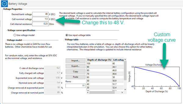

Hello everyone!
Im trying to simulate a saltwater battery as a Lead Acid: Custom PV-battery but have run into some problems.
When discharging or charging a large amout of kWh only a tiny fraction of the SoC is discharged/charged as you can see in this table: i.imgur.com/y1tT4LB.png
I was wondering what the problem would be? Why is the battery acting like this?
Im using this weather data and have attached the project file.
climate.onebuilding.org/WMO_Region_6_Europe/SWE_Sweden/UP_Uppsala/SWE_UP_Uppsala.University.024620_TMYx.2004-2018.zip
I would be very grateful for even the smallest bit of help!
Thank you in advance.

Replied by Paul Gilman on topic Incorrect SoC for Lead Acid: Custom PV-battery
Hi Benjamin,
You specified a custom voltage curve with a maximum cell voltage of 40 V but left the cell nominal voltage at its default 1.5 VDC. Changing the cell nominal voltage to 48 V will result in a more reasonably sized battery bank so that the battery charges and discharges at the rates you expect.
