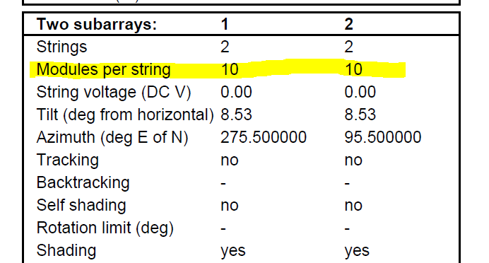

When I create a report and my system has more than one subarray, in the field "Modules by string" SAM puts the "modules by string" of subarray 1 in all other subarrays.
The following screenshots show what I say.
Looking a bit I think the error is in file "pv.samreport", in the line that says
"tbl_array [2] [col] = var ('subarray1_modules_per_string');". I think it should be
"tbl_array [2] [col] = var ('subarray' + i + '_modules_per_string');".
I tried to change it but SAM stopped recognizing the file.
Actually, just by opening and saving the file without changes, SAM stops recognizing the file.
Is there a way to modify "pv.samreport" file and keep SAM running or what should I do to fix the problem?
Thanks for your help.

Dear Javier,
Thank you for pointing out this issue. I have added it to our GitHub issues list, and we will address it as soon as we can.
github.com/NREL/SAM/issues/108
