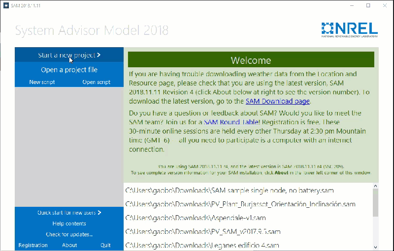

Hello Everyone,
I am a new user on SAM,
wondering how can I get the user interface to create a new project or case.
for example for Photovoltaic project I cannot see anywhere to create Detailed or PVWatts Model.
Could you support to get the right setup for that?
Thank You

Hi Farokh,
Here's a quick demo of how to create a Detailed PV / Commercial project. The process is similar for PVWatts or other models:
