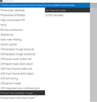

Hello dear Paul,
I just started with SAM. For my PhD research, in using SAM I hope to realize parabolic trough aided coal-fired power plant model simulation and I know that this type of hybrid system is not available in SAM, So I want to use parabolic trough (Only solar field and oil/steam exchanger) without power block and thermal storage because I only need solar field output parameters.I need help to realize this simulation. Thanks in advance.

Hi Seyni,
You may want to consider using the industrial process heat trough model:
[img width=400,height=421]file:///C:/Users/gaobo/AppData/Local/Temp/SNAGHTML1a28770b.PNG[/img]
