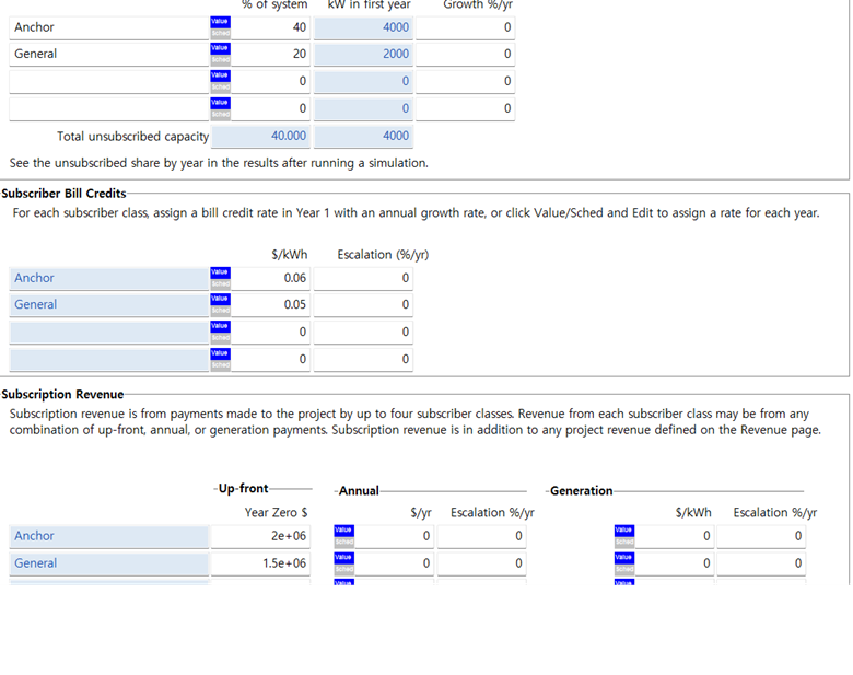

- i005034
26 Sep 2024 19:46 - 02 Oct 2024 13:30 #13460
by i005034
Replied by i005034 on topic Community - Subscriber's upfront payment_Subscriber NPV
Last edit: 02 Oct 2024 13:30 by Paul Gilman. Reason: Please attach images as files and then insert them into your message
- Posts: 5695
02 Oct 2024 13:39 #13473
Replied by Paul Gilman on topic Community - Subscriber's upfront payment_Subscriber NPV
SAM treats the revenue from up-front payments as a reduction in the total installed cost, similar to a cash incentive.
We implemented it this way because we did not have a lot of information about how these up-front payments would be treated in actual projects.
Can you provide details about how up-front payments are treated in your project?
