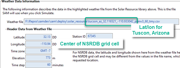

SAM displays the file name and latitude and longitude from the weather file on the Location and Resource page under "Weather Data Information." For example, this screenshot shows the result of a request I made using the location name "Tuscon, AZ:" The geocoding service returned the latitude/longitude pair 32.116521,-110.933042 that you can see in the file name. SAM then used that latitude and longitude to request data from the NSRDB, which returned a weather file for the grid cell centered 32.13,-110.94 that you can see under "Header Data from Weather File:"
