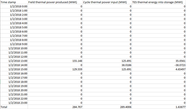

In my comment above, I was looking at hourly results. You are looking at monthly totals.
For a system with storage, consider this data for a single day. You can see how the daily sum of power values to power block is greater than the sum of power values produced by the field:

The reason that the sum of hourly power to power block is greater than the sum of power produced by field over some period of time is because of the nighttime hours when energy from storage goes to the power block. You can see that in the table above.
You can estimate the shadowing loss by multiplying the "Field collector row shadowing loss" by "Field thermal power produced."
