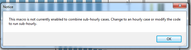

How can i solve this problem shown in the picture below, it appears when i try to combine two PV systems using the Generic System.

The "Combine Cases" macro is not designed to work with sub-hourly simulations. If you are using weather files with subhourly (15-minute, 30-minute, etc.) data instead of hourly data, you will have to switch to a weather file with hourly data.
If you are not using subhourly weather data, please attach a copy of your .sam file so I can investigate.

I double checked and looks like i am using hourly data not subhourly.
here i attached my sam file if you could check on it.
