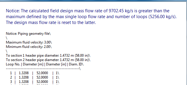

How can i solve the problem related to the mass flow rate in my CSP system as shown in the picture below?
Note that this problem only appears when i use Generic System to combine CSP system and PV system, it does not appear when i simulate for CSP system alone.

Hi Ayman,
I cannot think of a reason why you would get different results running the case by itself or from the Combine Systems macro.
UPDATE: As of SAM 2021.12.02, the Combine Cases macro is replaced by the Calculate generation profiles and nameplate capacity from open cases option on the Power Plant page for the Generic System model and Generic Battery model. See the SAM YouTube channel for a short tutorial .
Could you attach a copy of your .sam file so I can investigate?

Thank you for sending the file. It does not contain a Generic System case, so I was not able to test it with the Combine Cases macro.
However, I did see the message about the mass flow rate for the "CSP 10" case. Because it is not a critical problem, SAM displays the message on the "Notices" tab of the results page but does not display it as a simulation message.
