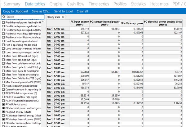

22 Apr 2021 22:05 #9505 by Paul Gilman
Replied by Paul Gilman on topic Trough system power estimates
Hi Jessica,
This screenshot shows the Data Tables tab on the Results page with variables that show that for hours except startup hours,
PC Gross Output (MWe) = PC Input (MWt) * PC Gross Efficiency
For startup hours, please see my final response in this thread: sam.nrel.gov/forum/forum-general/1987
