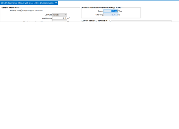

22 Mar 2022 05:02 #10716
by Asif K
Replied by Asif K on topic PV Modules and Inverters not in Database
Why I can't change the Nomianl Maximum Power Point Rating pf the PV Module while using the CEC Performance Model with User Entered Specifications
28 Mar 2022 15:08 #10742
Replied by Paul Gilman on topic PV Modules and Inverters not in Database
Hi Asif,
Please see my reply to Lester above.
