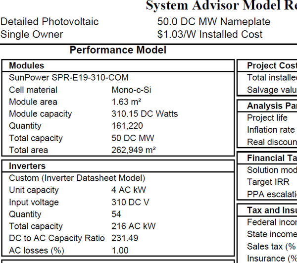

07 Apr 2021 15:17 #9435 by Paul Gilman
Replied by Paul Gilman on topic PV Modules and Inverters not in Database
Hi Ayesha,
I did some tests and was not able to replicate this. The PDF report generator should work with the Inverter Datasheet Model option:
Could you attach or send me a file that causes SAM to crash?
